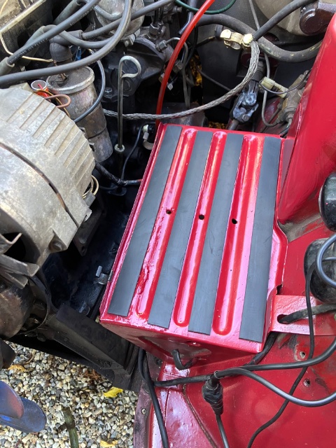

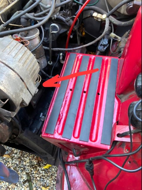

Re: Cuts out when hot at idle and difficult to restart.
It's hard to see but it looks like you do have a ballast resistor fitted and wired up. Owner often remove / bypass them and fit a 12v coil. My 1973 PI definately still has a ballast resistor fitted.

I will send a close up of my coil tonight, it has capacitors and resistors all over it. Think the PO must have had shares in an electronics factory.
My only choice of new coil from Moss is 12v ballested, or 12v unballasted…if i get the ballasted can I do away with any additional resistor?
