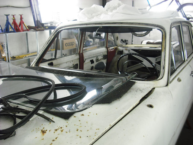

Ok, next update. I´ve removed the master cylinders, servo and the clutch slave cylinder too. Unsurprisingly their condition is not good after a 29-year slumber and the master cylinders will need to be replaced or sleeved. The servo is full of fluid but could be rebuilt if I can find a kit to do so.
I´ve also started to remove body trim and both the windscreens, taking great care not to bend any of the stainless parts !
Slowly making my way towards a bare shell. Could be a while yet though.

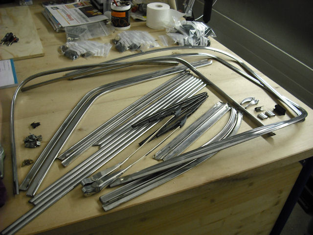

A pleasant few evenings have been spent this week removing the remaining stainless trim sections from the exterior and starting to strip out the interior, in preparation for body repairs.
I´ve also been busy hunting for hydraulic repair kits. So far i´ve managed to source a replacement clutch slave cylinder and a repair kit for the brake master cylinder, which after much honing, looks to have survived !
The clutch master cylinder is also serviceable after a good hone but so far, no luck in finding a repair kit. I did think it might be the same as Stag but I now suspect this might not be true. Hopefully a contact I made this week will be able to supply such a repair kit as well as a diaphragm and a repair kit for the servo cylinder.
