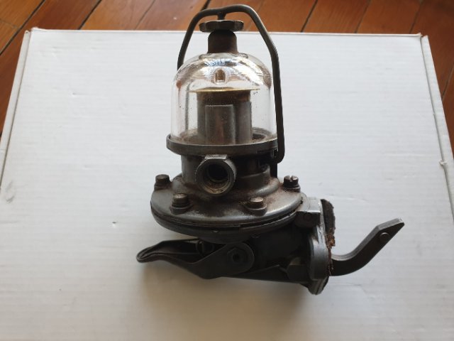

I have kept the original. The reason i did not get a kit for it is that i was informed that if the issue is located in the valves, the valves from the service kit do not fit as they should. If it is the diaphragm, then it can be repaired.
I did not want to gamble so i bought a new pump (only to realize that i was still gambling with this decision as the aftermath proved to me. . .)
Eventually, i ordered a service kit for the old pump and hope that IF it had any issue, this had to be in its diaphragm. (the issue was that it produced bubbles, and a noise)
I will have to be extra careful when dismantling though, and avoid breaking the glass bowl as it is stuck with the body of the pump!
Re: The PowerTune fuel pump - in need of new gasket
Posted: Mon Dec 30, 2024 10:57 am
by johnnydog
The glass bowls on the original pump were pretty robust, and I suspect it will only be stuck to the rubber seal in the body. A sharp tap with a small leather / rubber hammer will free it without damaging or breaking the bowl. Even if it did break, then I have spare bowls from pumps I've dismantled over the years!

by Matrix
thanks JohnnyDog!
