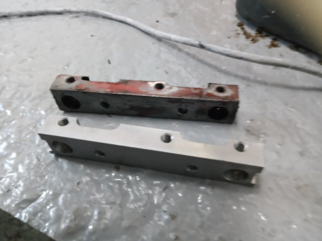

This is my job for this weekend! The gasget is leaking and the front sealing block threads are stripped for one of the bolts. I have a new steel replacment from TRGB.

Well, just to let you know. I ended up removing the front cross member as described by Mike and John above. I couldn't turn the sump 90 degrees with the downpipe attached. None the less the cross member was not too bad to "remove" as described by John, I also had to unbolt the rack from the cross member and drop the steering column out! Left the cross member "hanging down" and likewise the rack still attached to the track rod ends. Had to undo the Power steering pump as well to get aenough free play but apart for that no problem... Seriously not as bad as it sounds.

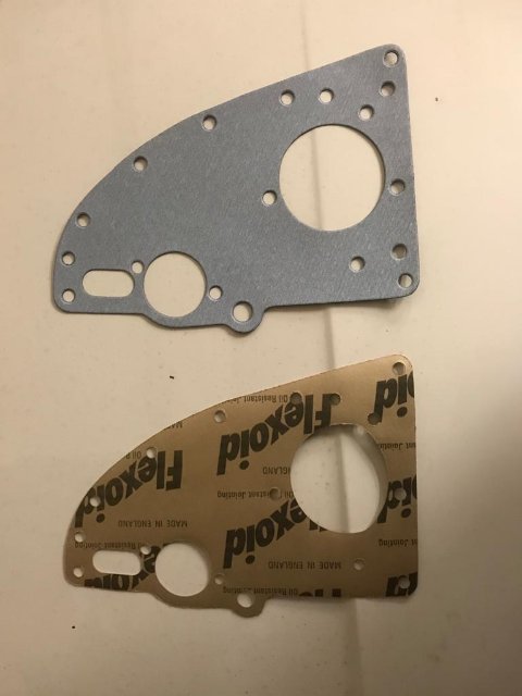

Interestingly the issue with the leak was the front sealing block as mentioned by "Herald 1360" only on mine the 2 end bolts through the front conversion plates were missing altogether! I notice there are 2 front conversion plate gaskets supplied in a bottom end gasket set. A beige one and a grey one, the grey one appears to be thicker than the other? When you look the Beige gasket doesn't have the holes punched in it for the those bolts but the grey one does? Why is that?
Anyway my engine was fitted with a beige gasket, so I poked the holes through with a drill by hand and refitted the sealing block with the wooden wedges (these weren't fitted but the void was full of silicon sealer) then put it all back together.

I change my sump gasget on Saturday
To get the sump off I had to drop the crossmember by about half and inch, remove the two lowest bell housing bolts including the clutch slave cylinder. Removeed the dipstich and turned the crank untill i could pull the sump down.
I replaced the front sealing block as one of the sump attachment holes the threads had stripped, causing an oil leak. I replaced with a steel sealing block from TRGB, excellent quality and fit.
I cleaned the sump of all the silvery gunge in the bottom, fited new gasget and refitted.
I used Locktite thread sealer on all sump bolts, putting plenty on from and rear bolts which go into the crankcase.
