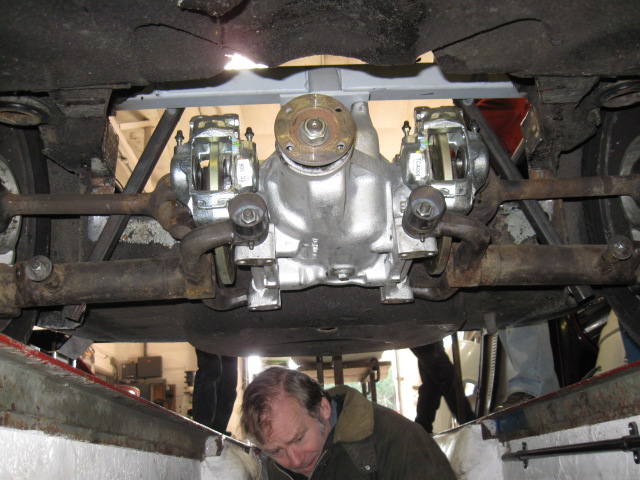

Why you may ask? Future plans for a Chevy LS3 6.2 all alloy (Monaro VXR8) engine would blow even a BMW diff and I love independent rears!
The fabrication work is being done at Pete Farmer Performance Racing Ltd, (google petefarmer.com) in Wilton nr Salisbury, Wilts. He is well known at producing awesome race cars (mostly Healey 3000's) and was used because of his experience of Jag IRS installations in various cars.
Should be on the road next year still running the PI lump whilst development takes place.
Still to do list : A Rover SD1 Vitesse servo and tandem master cylinder will be used together with Jag stubs/hubs/discs and very heavy calipers, until lightweight Willwoods or similar are sourced cheaply, to keep it 5 stud all round. Propshaft,battery relocation to the boot, coilovers, alloy fuel tank and rear section of exhaust still to be fabricated. Then the whole lot sprayed and put back together again. Graham

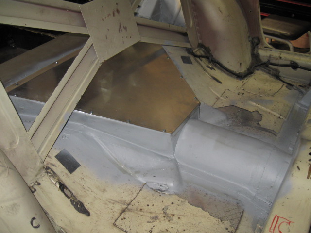

This is great engineering, just what I like. Just not sure this isn't going to twist. The Triumph box sections and diff rear mounts are cruciformed at four parts of the chassis. Is the metal work in the center of the body substantial enough. Just mouthing off - as I tend to do.

Yes I considered this also Steve. The box section between the inner arches has gussets welded to them to spread the load a bit better. The coilovers when installed are attached to this box section so it had to be substantial. The diff maintenance cover is screwed on so if there is any weakness it will show here. There are 2 radius rods underneath with a bush at one end and a rose joint at the other, supported at the X member under the rear seat. What you don't see clearly in the pics are the two diff supports (either side and spread upwards and outwards) mounted to brackets welded onto the existing box sections near the old spring seat. My camera batteries ran out. The new arches are steel and seam welded on to the inner and outer arches for strength. A roll cage is on the shopping list! :wink:

Peter Jackson helped a lot in the welding department. He was sweating!
Took a bit of bottle to cut out the old arch. 45 spot welds each side!
rear arch shape and approx position for 8X15 wheels and 225/50 tyres
This is the car stripped and a lot of structural work done including working out rear arch position
