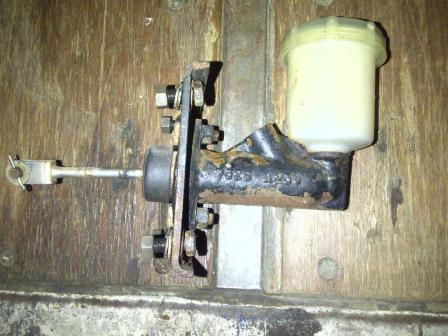

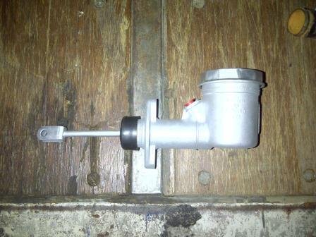

Can anyone help with advice on the correct brake master cylinder for a Mk1 PI?
I have two types which came off two Mk1 PIs, both single circuit Girling, but I'm not sure which one is original spec (or perhaps both are!). One is completely metal, with an integral reservoir and is a Girling .875" part no. 64065575. The other one has a plastic reservoir and part no. 7326 0230 cast into the metal piston body. Hopefully I've successfully attached pictures below!

both my PI's have the same as first picture.
Sorry my picture a little small....................

Thanks Lee - can't quite make it out on the tiny photo, but I am more than happy to take your experienced word for it! Could you let me know what finish the metal parts have - black paint, silver paint, or bare casting?
Readers may have noticed that the correct master cylinder is in need of some "tlc", while the incorrect one is all shiny and reconditioned. Note to self - check with people who know before parting with cash...

Both my car and that of my boss have cast Aluminium master cylinders as shown in the second picture.
Could there be a difference between home market RHD and export LHD specifications ?

I believe alloy is original

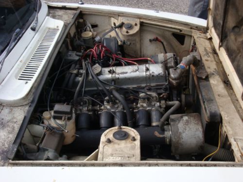

I´m not sure where the RHD remote servo unit is located, but the LHD one is shown in the picture below behind the red HT leads on the far side of the engine bay. It´s mounted on a bracket fitted to the rear edge of the battery tray.
I´ve also had a look through an original Mk1 parts book at work today - just one part number (152460) is given for the master cylinder so it would seem the same part is used for both LHD & RHD vehicles.

I agree with Andy, mine has the integral aluminium resevoir and I think that is OE.

Thanks all for your help. I'll go with the majority - Chris Witor also thought the all-metal one was correct. The schematic diagrams in the workshop manual (which has separate section for the Mk1 PI system) look like that type - not in itself categoric proof, but useful to back up actual evidence.
