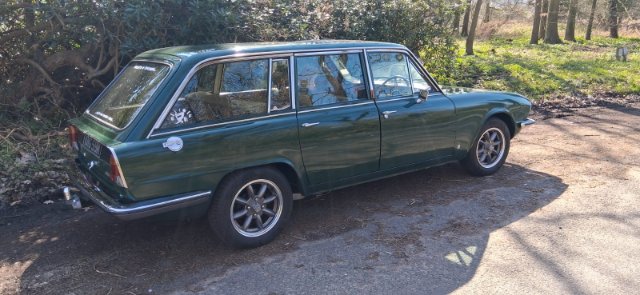

A picture Peter sent me on his test run, in sunny Kings Lynn on Thursday, after pasting the nearest hill in his flat living area 😄
