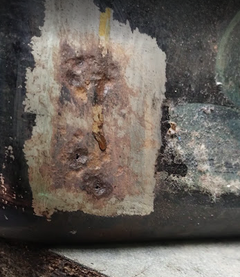

An update on my petrol tank issue...I have discovered 2 holes in the bottom nearside corner
Not only have I got the inside to sort, but the outside too. Any thoughts on hole repairs anyone?
I would upload a picture of the holes, but can't seem to do it...

...well that fooled me...the pictures did upload.....

I’d say get a new tank if its that far gone…those two holes are probably just the tip of the rustburg.
