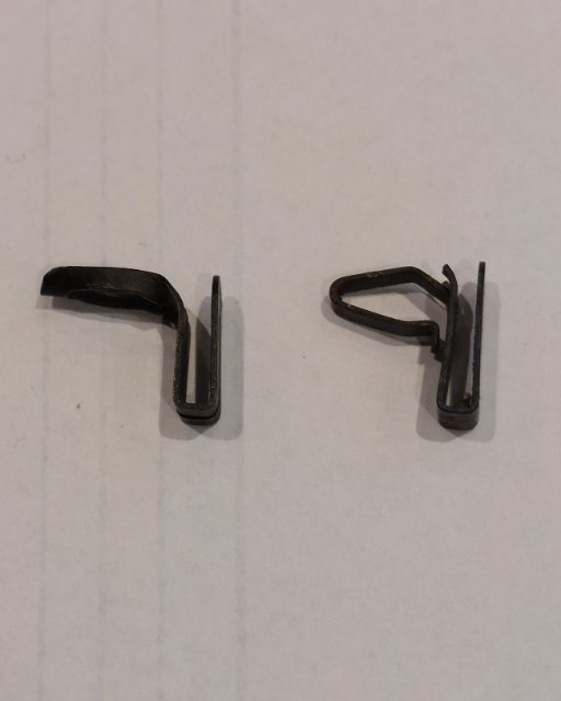

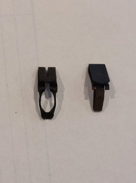

Slight correction there Charles - the gear lever base uses similar clips to the door cards, but they are actually different.
The door card clips are a bent piece of single strand sprung steel, whereas the gearlever base clips are oval shaped. I find the correct clips grip the holes better in the gearlever console.
Probably why you see the base popping up on some cars when reverse is selected because the wrong clips are fitted - hence why many cars have self tappers to secure the base which looks terrible imho.
I'll try to post pictures of the two different clips when I find some the oval types...
Re: Gear lever trim
Here are a couple of pics showing the two different trim clips - the right one for the door cards, the left one for the gear lever base cover on the centre console.

Thanks for digging these clips out. Agree screws will look poor / bodged.
