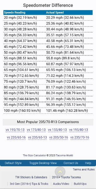

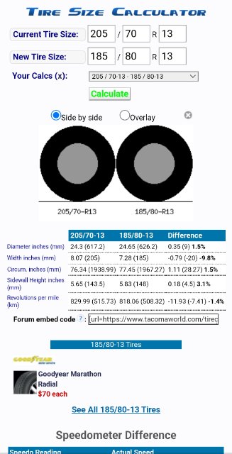

The nearest tyre size to the original 185 80 13 is 205 70 13. This gives the nearest rolling circumference to the original and to the visual size.
Here are details from a 'alternative tyre size website' which gives the differences in physical size, measurements and speedo throwout.

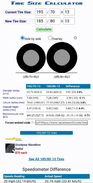

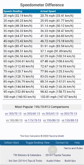

#9 Post by johnnydog »
Just for comparison purposes, here are the details of a 195 70 13 tyre, which as you can see is greatly different to the original tyre size of 185 80 13, and is not suitable in my opinion as an alternative.
