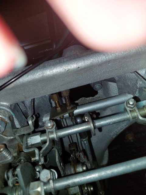

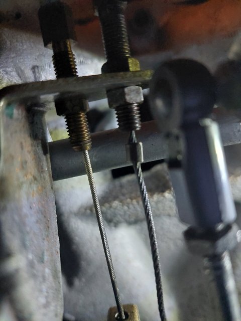

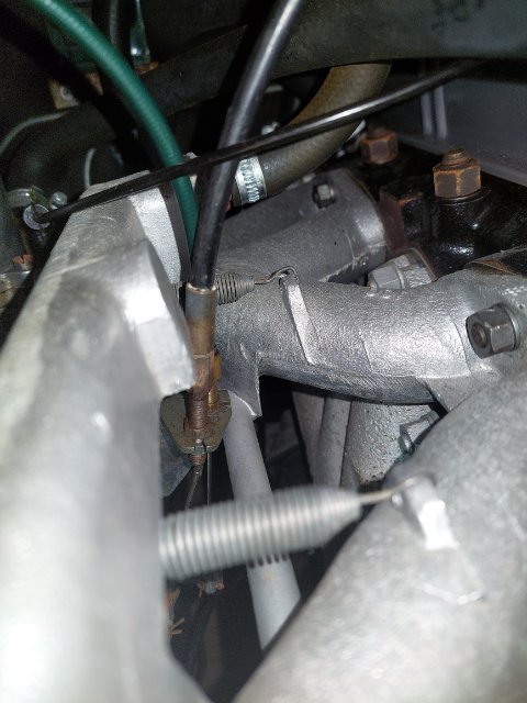

Ok - been a bit of a mission to get these up but here are a few pics, taken as best we can of the kickdown cable as it is now - bit awkward to get a good side on view - too much in the way !! This is how it sits now, so that is AFTER I have taken up some slack - but intend to have another go, as it still seems slack....Hope this gives some idea of where the cable and the crimp lies.....

That's a good shot,clearly shows the gap between the crimp and the outer cable threaded end, looks like there is a bit more adjustment needed to take out the slack so that the crimped stop meets the outer cable.
Re: Autobox queries - kickdown cable slack
Thank you Simon - I imagine you appreciate just how difficult that shot was to take
It took 4 hands, 2 torches, 1 phone, 1 ambidextrous wife, LOADS of **********, Divorce Lawyers on speed dial .....
So the latest is..... that pic was taken last night ( Sunday). That was AFTER I had adjusted some of the slack out from the initial drive - when i realised i was not hitting top gear - so the setting you see there is how I drove it on the second run around town last Friday, but again still did not feel I was getting top gear.
Went back out this evening to pull more of the threaded tube ' up through the bracket' to, in effect, take up some more slack, which to me made sense. But all that did was widened the gap between the end of the threaded tube, and the crimp
HUH?
So I have now altered the threaded tube ( outer) BACK DOWN to give the position of the crimp being just shy of the said threaded tube ( hope that makes sense) . But the remaining cable now still feels slack
I do think I am banging head to wall on this now - Iv'e got the gearbox oil,got the pan gaskets - I just think it needs to go back to the workshop as planned, start from scratch with the SU's as suggested, drop the 'box pan and set the cable up from there....
