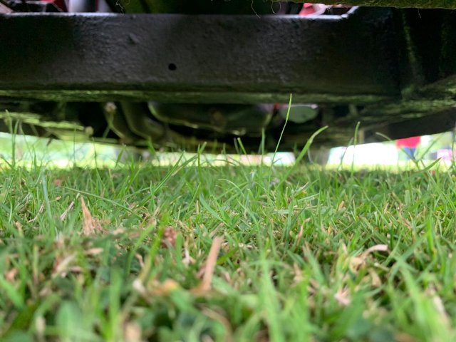

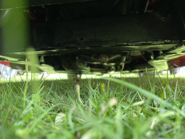

Hi Cliff, I believe it is a matter of access though I don't know. Anyway here are a couple of photos I took at a show this weekend.
They are a bit dark but both the TR5 and early TR6 sump pans are the same with the oil drain to the front end of the sump and in the centre, the sump being appropriately shaped to make that the lowest point.
