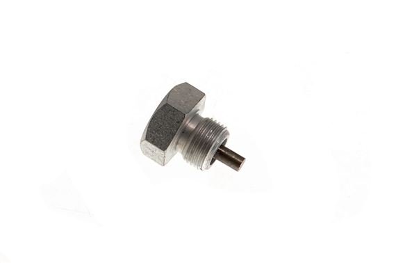

Re: Oil sump plug wont budge
Here's a picture of the magnetic type - it is a 3/8 BSP thread according to CW, but he has no stock.
