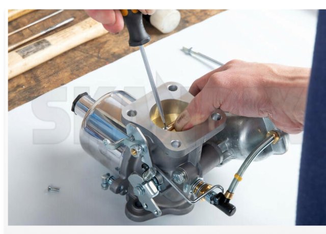

I now have another question regarding spring positions on the HS6 Carb. So- regarding the cam set up that moves the jet - the inboard spring tail, that has a 90 bend, locates on a lug that is part of the body. The other end - does anyone know if that tail is meant to seat Under, or Over the jet link arm ( the arm with the circlip) . I have pictures should anyone need them, as it is hard to explain,i think!!!

Posts: 1873
Re: HS6 rebuild kit/ needle option
#8 Post by johnnydog »
Does this help?
Taken from this website..
https://www.skandix.de/en/documents/ins ... e/3000688/

Mmm unfortunately not quite, just cant quite see all the spring tails. I wish mine looked that shiny though!!!! I ask as having stripped one, leaving the other complete as a reference, and with taking plenty of notes and pictures of every step, again for reference, i had real trouble trying to re-seat that inner spring to where it was on removal - the 90 bend to the carb body was obvious - it was the other end. So after several attempts over several evenings i thought about checking the other, yet undisturbed front carb - the tail was in a different place - under the arm, not on top !!! So a bit of headscratching - so they were both different - but which is correct.... assuming both would seat in the same position.... so setting the tail under the arm, then looping a piece of string around the 90, i was able to pull it up through and around, and fit behind the lug... so, it now matches the other carb. So i'm now assuming that spring was not fitted correctly, and wondering if that had any consequence to engine responce..
