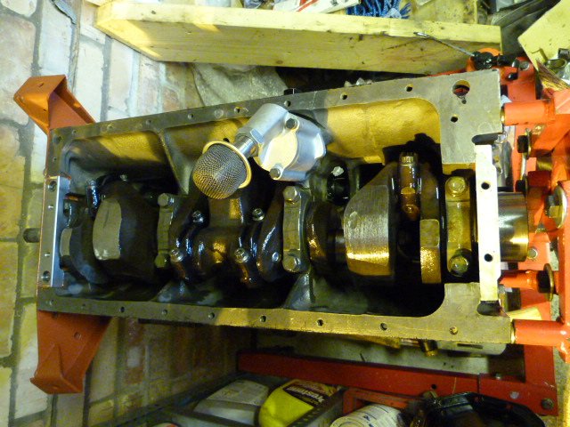

Anyhow the crank is back in with new vandevell shells. The thrust washers have been done one std one oversize and the rear crank seal is back on. The pistons have rings on with the gaps all checked. New oil pump checked for tollerance you never know it could be wrong. Next to go on is a new front sealing block from jigsaw racing. It needs a little fettling to fit. No-one seems to make things properly these days or check them for correct fit.

The crank is in and endfloat set. The rear oil seal housing is in. The front bridge piece is in, those wooden wedges are a pain they broke up when being tapped in. I made more of my own. It took ages to find all the little pieces of wood!

The oil pump is in and a new relief valve fitted, with the sump temporarily fitted to keep the dust out.
