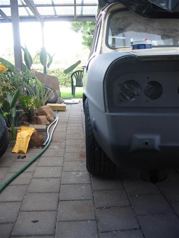

I'm thinking of fitting the same wheels to my mk1 PI and got directed to this topic by Colin. (thanks for that!) Must say they do look good on the car, although I'm curious on the clearance at the rear. My mk1 has the wider mk2 rear end and lowered suspension.
Any detailed photos of the rear arch clearance are welcome!

My PI is off the road for body work and I haven't actually got the wheels fitted at the moment. (I haven't driven it with them fitted either, so can't really confirm 100% how good/ bad the clearance is.)
All I can say is it appears like I might not need to roll the guards.
However, I get the feeling my rear trailing arm bushes might also be shot as I seem to have a lot of toe in on the rear?

Toe in is adjusted by shims between the outer shackles and subframe.murcod wrote:I seem to have a lot of toe in on the rear
Do you mean toe-in? Excessive camber can be caused by the holes in the rear subframe elongating. These are the ones where they bolt to the diff nose.

Toe in, not camber. It might just be an optical illusion???
I'll get a wheel alignment once it's painted and the suspension bushes are done- that will show up any issues.

A long time since I bought the wheels, and a lot of work has been done before fitting them. I discovered all my rear end arm bushes were shot and totally worn out. The RHS swing arm bushes were so bad that the alloy sleeve in the arm had worn away and I had to find a replacement arm!
Anyway, the alloys are fitted now and they rub on decent bumps and when cornering- so the "optical illusion" was actually the rear end so far out of alignment due to wear. I'll need to roll the guards.

I rolled the guards on the weekend -DIY and the first time I've done it. The first one was a bit of a flop with paint cracking, but I think that was due to some filler under the paint? The second side worked like a dream- using a proper bolt on roller and heating the panel with a heat gun.
I've got so much clearance now that I reckon I could fit 215 width tyres.
