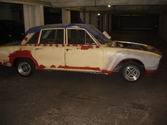

You are in the world of jdm spec fella - and have a HUGE aftermarket supply not so far from you guys. I went shopping there for mine
close-up
just surf yahoo.jp - loads on there (BUT SOLD IN PAIRS) and a couple of googles will give you a translation/handle service if you want them to take care for you - and it doesn't cost much either.
