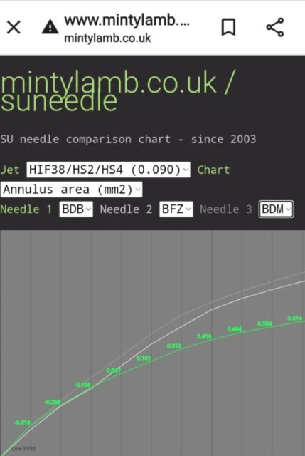

I have a 1976 2500S with HS6 carbs and the engine is totally standard in every respect.
Initially it had Waxstats with poppet valves on the butterflies. Whilst it ran very well, I thought it ran out of puff at higher revs, although there was none of the symptons you describe. I changed it years ago to standard butterflies and red tipped jets.
I also decided to change the needles from the original BDB. I used the Minty SU website, which allows the comparison of different needles relative to each other. At the time, I basically inputted various needles from all different Triumph models until I got the best (in my opinion) mixture curve against BDB needles, trying to get the mixture the same at the bottom end to retain the smooth tick over, but richer at higher revs.
I settled with BDM needles. I fitted them in 2006 and they have been in ever since with no issues, with no detriment to fuel consumption, but a marked difference in 'uumph' and 'pull' / 'eagerness'.
CW recommends BPZ needles for a 2.5PI engine fitted with HS6 carbs which I didn't consider at the time for some reason.
But here is a screenshot of the mixture range of the three needles for comparison. As can be seen, the BDM needles are very similar at low revs, but get then get slightly richer up the rev range. They actually produce a consistent increase of mixture in the upper rev range as do BPZ, are slightly richer but give a more even increase up the rev range.
Dave B has a standard 2500 engine on HS6 carbs, but fitted with BPZ needles from the days when the car had a PI engine fitted. It is now on a later 2500 engine, still with BPZ and it also pulls very well.
I think you need to experiment to find the best for your engine, but these are some options based on my experiences with my 2500S and Dave B's....

thanks for your reply...i´m already a user of the minty SU homepage.
yesterday i have received my BDN Needles...i havefitted them without touching the jet-settings:
and they are worse in every aspect:
Idle is a bit lower, until 2500rpm i can only drive with a wide open throttle , otherwise the engine dies and the cutouts on high revs have moved 300rpm higher....pulling the choke and the sympthoms (on low as on hig revs) are gone.
so i´m now (temporay) back to my BAM´s as with those the engine runs well up to 4500rpm
by the way: my carbs dont have the butterfly valves, nor waxstats.
BDP compared to BAM´s are much leaner....so they cannot work at all in my specific case
BDP compared to BDM´s are slightly richer
BPZ´s cannot be found in the minty table, only BP...and they are constantly richer from low to high compared to the BAM´s , surplus a sudden increase of richness on quite high revs.
i would need to find a neele which is identical to BAM up to 60% of the revs and than it should get richer.
i already searched for hours at minty but cannot find anything.
BCG looks not bad but gets richer quite early.
