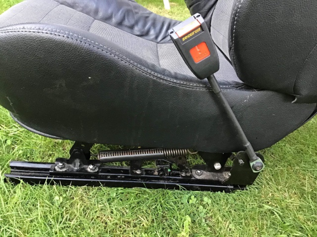

Update on our MG ZTT seats. My partner in crime Martin took the seats out to clean them. In a fit of curiosity I asked him if our Securon seat catch stalks would bolt to the seat rather than the transmission tunnel. It turns out that the standard MG/Rover fitting has exactly the same bolt diameter as the aftermarket Securon item.

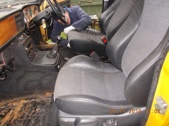

The seats came out when we decided to fit the seat belt stalk to the seat base rather than the transmission tunnel. The old transmission tunnel seat belt mount will be used to fit a 2kg fire extinguisher. The passenger parcel shelf will come out to give my long legged Co-pilots more room in the footwell - both are about 6’ 4”

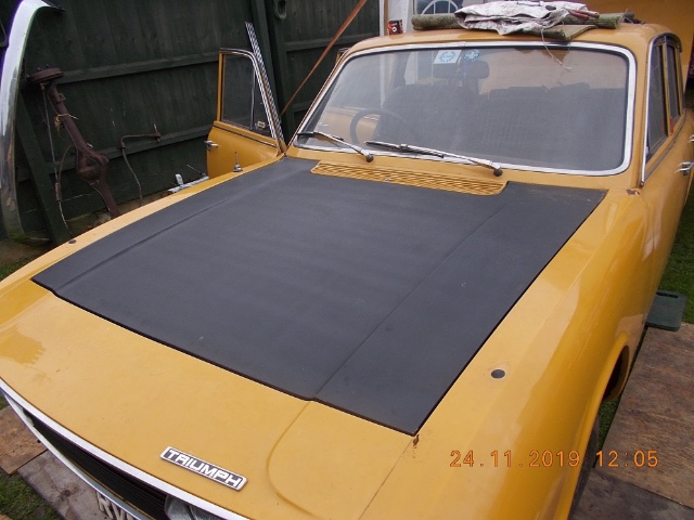

The original bonnet was shot with rust holes on the top surface along the line of the cross-brace. I had picked up another good bonnet from eBay last year and Lee had painted it matt black. Lee had also cleaned up the front grill and sprayed that up as well.

Attention turned to the dials and dashboard. Originally we planned to fit a 2500S dashboard with rev counter, but the plugs are different. There is already a rats nest of scotch locks and varied non-standard Lucas wire colours making it difficult to work out what was what, so we’ve junked the idea of fitting the 2500S dash and tried to sort out the existing dash.
